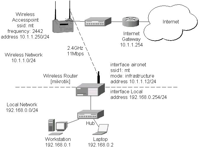

Point-to-Multipoint Wireless LAN
Let us consider the following network setup with CISCO/Aironet Wireless Access Point as a base station and MikroTik Wireless Router as a client:
The access point is connected to the wired network's HUB and has IP address from the network 10.1.1.0/24.
The minimum configuration required for the AP is:
- Setting the Service Set Identifier (up to 32 alphanumeric characters). In our case we use ssid "mt".
- Setting the allowed data rates at 1-11Mbps, and the basic rate at 1Mbps.
- Choosing the frequency, in our case we use 2442MHz.
- (For CISCO/Aironet Bridges only) Set Configuration/Radio/Extended/Bridge/mode=access_point. If you leave it to 'bridge_only', it wont register clients.
- Setting the identity parameters Configuration/Ident: Inaddr, Inmask, and Gateway. These are required if you want to access the AP remotely using telnet or http.
The IP addresses assigned to the wireless interface should be from the network 10.1.1.0/24:
[admin@MikroTik] ip address> add address 10.1.1.12/24 interface aironet [admin@MikroTik] ip address> print Flags: X - disabled, I - invalid, D - dynamic # ADDRESS NETWORK BROADCAST INTERFACE 0 10.1.1.12/24 10.1.1.0 10.1.1.255 aironet 1 192.168.0.254/24 192.168.0.0 192.168.0.255 Local [admin@MikroTik] ip address>
The default route should be set to the gateway router 10.1.1.254 (! not the AP 10.1.1.250 !):
[admin@MikroTik] ip route> add gateway=10.1.1.254 [admin@MikroTik] ip route> print Flags: X - disabled, A - active, D - dynamic, C - connect, S - static, r - rip, b - bgp, o - ospf, m - mme, B - blackhole, U - unreachable, P - prohibit # DST-ADDRESS PREF-SRC G GATEWAY DISTANCE INTER... 0 A S 0.0.0.0/0 r 10.1.1.254 1 aironet 1 ADC 192.168.0.0/24 192.168.0.254 r 0.0.0.0 0 Local 2 ADC 10.1.1.0/24 10.1.1.12 r 0.0.0.0 0 aironet [admin@MikroTik] ip route>

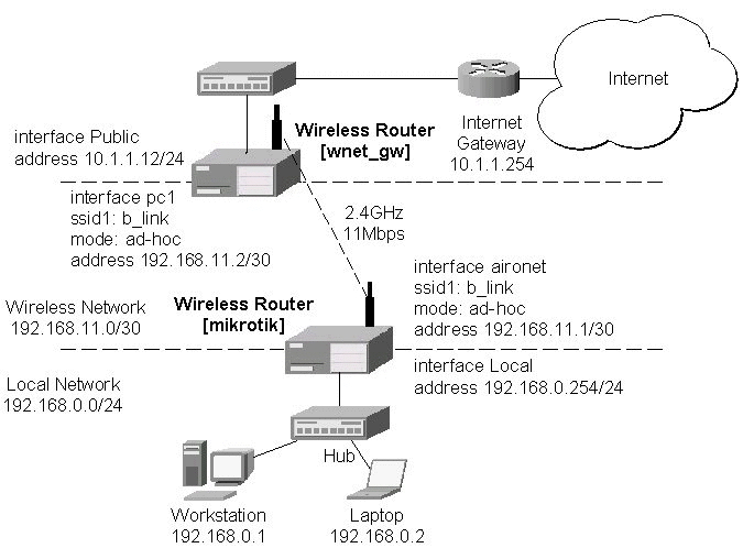

Point-to-Point Wireless LAN
Point-to-Point links provide a convenient way to connect a pair of clients on a short distance.
Let us consider the following point-to-point wireless network setup with two MikroTik wireless routers:
To establish a point-to-point link, the configuration of the wireless interface should be as follows:
- A unique Service Set Identifier should be chosen for both ends, say "mt"
- A channel frequency should be selected for the link, say 2412MHz
- The operation mode should be set to ad-hoc
- One of the units (slave) should have wireless interface property join-net set to 0s (never create a network), the other unit (master) should be set to 1s or whatever, say 10s. This will enable the master unit to create a network and register the slave unit to it.
The following command should be issued to change the settings for the pc interface of the master unit:
[admin@MikroTik] interface pc> set 0 mode=ad-hoc ssid1=mt frequency=2442MHz \ \... bitrate=auto [admin@MikroTik] interface pc>
For 10 seconds (this is set by the property join-net) the wireless card will look for a network to join. The status of the card is not synchronized, and the green status light is blinking fast. If the card cannot find a network, it creates its own network. The status of the card becomes synchronized, and the green status led becomes solid.

The other router of the point-to-point link requires the operation mode set to ad-hoc, the System Service Identifier set to 'mt', and the channel frequency set to 2412MHz. If the cards are able to establish RF connection, the status of the card should become synchronized, and the green status led should become solid immediately after entering the command:
[admin@wnet_gw] interface pc> set 0 mode=ad-hoc ssid1=b_link frequency=2412MHz \
\... bitrate=auto
[admin@wnet_gw] interface pc> monitor 0
synchronized: yes
associated: no
frequency: 2442MHz
data-rate: 11Mbit/s
ssid: "b_link"
access-point: 2E:00:B8:01:98:01
access-point-name: ""
signal-quality: 131
signal-strength: -83
error-number: 0
As we see, the MAC address under the access-point property is the same as on the first router.
If desired, IP addresses can be assigned to the wireless interfaces of the pint-to-point linked routers using a smaller subnet, say 30-bit one:
[admin@MikroTik] ip address> add address 192.168.11.1/30 interface aironet [admin@MikroTik] ip address> print Flags: X - disabled, I - invalid, D - dynamic # ADDRESS NETWORK BROADCAST INTERFACE 0 192.168.11.1/30 192.168.11.0 192.168.11.3 aironet 1 192.168.0.254/24 192.168.0.0 192.168.0.255 Local [admin@MikroTik] ip address>
The second router will have address 192.168.11.2. The network connectivity can be tested by using ping or bandwidth test:
[admin@wnet_gw] ip address> add address 192.168.11.2/30 interface aironet
[admin@wnet_gw] ip address> print
0 192.168.11.2/30 192.168.11.0 192.168.11.3 aironet
1 10.1.1.12/24 10.1.1.0 10.1.1.255 Public
[admin@wnet_gw] ip address> /ping 192.168.11.1
192.168.11.1 64 byte ping: ttl=255 time=3 ms
192.168.11.1 64 byte ping: ttl=255 time=1 ms
4 packets transmitted, 3 packets received, 25% packet loss
round-trip min/avg/max = 1/1.5/3 ms
