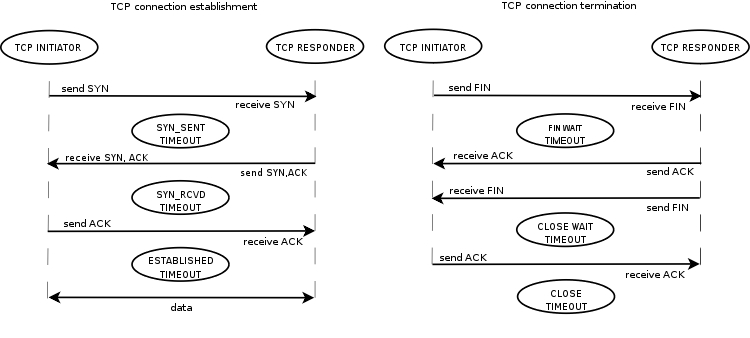

Submenu level: /ip firewall connection trackingDescription
Connection tracking provides several timeouts. When particular timeout expires the according entry is removed from the connection state table. The following diagram depicts typical TCP connection establishment and termination and tcp timeouts that take place during these processes:
Property Description
enable (yes | no; default: yes) - whether to allow or disallow connection trackinggeneric-timeout (time; default: 10m) - maximal amount of time connection state table entry that keeps tracking of packets that are neither TCP nor UDP (for instance GRE) will survive after having seen last packet matching this entry. Creating PPTP connection this value will be increased automaticlyicmp-timeout (time; default: 10s) - maximal amount of time connection tracking entry will survive after having seen ICMP requestmax-entries (read-only: integer) - the maximum number of connections the connection state table can contain, depends on an amount of total memorytcp-close-timeout (time; default: 10s) - maximal amount of time connection tracking entry will survive after having seen connection reset request (RST) or an acknowledgment (ACK) of the connection termination request from connection release initiatortcp-close-wait-timeout (time; default: 10s) - maximal amount of time connection tracking entry will survive after having seen an termination request (FIN) from respondertcp-established-timeout (time; default: 1d) - maximal amount of time connection tracking entry will survive after having seen an acknowledgment (ACK) from connection initiatortcp-fin-wait-timeout (time; default: 10s) - maximal amount of time connection tracking entry will survive after having seen connection termination request (FIN) from connection release initiatortcp-syncookie (yes | no; default: no) - enable TCP SYN cookies for connections destined to the router itself (this may be useful for HotSpot and tunnels)tcp-syn-received-timeout (time; default: 1m) - maximal amount of time connection tracking entry will survive after having seen a matching connection request (SYN)tcp-syn-sent-timeout (time; default: 1m) - maximal amount of time connection tracking entry will survive after having seen a connection request (SYN) from connection initiatortcp-time-wait-timeout (time; default: 10s) - maximal amount of time connection tracking entry will survive after having seen connection termination request (FIN) just after connection request (SYN) or having seen another termination request (FIN) from connection release initiatortotal-entries (read-only: integer) - number of connections currently recorded in the connection state tableudp-stream-timeout (time; default: 3m) - maximal amount of time connection tracking entry will survive after replay is seen for the last packet matching this entry (connection tracking entry is assured). It is used to increase timeout for such connections as H323, VoIP, etc.udp-timeout (time; default: 10s) - maximal amount of time connection tracking entry will survive after having seen last packet matching this entryNotes
