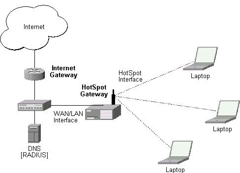

MikroTik HotSpot Gateway should have at least two network interfaces:
- HotSpot interface, which is used to connect HotSpot clients
- LAN/WAN interface, which is used to access network resources. For example, DNS and RADIUS server(s) should be accessible
The diagram below shows a sample HotSpot setup.
The HotSpot interface should have an IP address assigned to it. Physical network connection has to be established between the HotSpot user's computer and the gateway. It can be wireless (the wireless card should be registered to AP), or wired (the NIC card should be connected to a hub or a switch).
