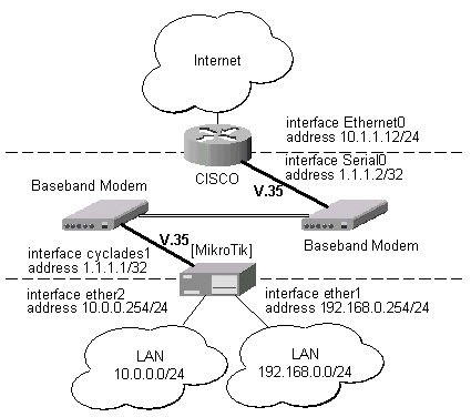

Let us consider the following network setup with MikroTik Router connected to a leased line with baseband modems and a CISCO router at the other end:
The driver for the Cyclades PC300/RSV Synchronous PCI Adapter should load automatically. The interface should be enabled according to the instructions given above. The IP addresses assigned to the cyclades interface should be as follows:

Note that for the point-to-point link the network mask is set to 32 bits, the argument network is set to the IP address of the other end, and the broadcast address is set to 255.255.255.255. The default route should be set to gateway router 1.1.1.2:
[admin@MikroTik] ip route> add gateway=1.1.1.2 interface=cyclades1
