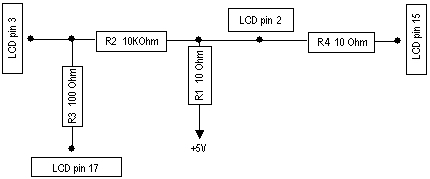

Note that there are some PowerTip PC2404A modules that have different pin-out. Compare:
Some LCDs may be connected without resistors:
| DB25m | Signal | LCD Panel |
| 18-25, GND | Ground | 1, 3, 4, 16 |
| +5V | Power | 2, 15 |
