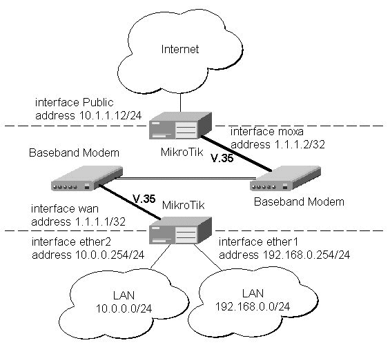

Let us consider the following network setup with two MikroTik Routers connected to a leased line with baseband modems:
The driver for MOXA C502 card should be loaded and the interface should be enabled according to the instructions given above. The IP addresses assigned to the synchronous interface should be as follows:
[admin@MikroTik] ip address> add address=1.1.1.1/32 interface=wan \
\... network=1.1.1.2 broadcast=255.255.255.255
[admin@MikroTik] ip address> print
  #   ADDRESS            NETWORK         BROADCAST       INTERFACE
  0   10.0.0.254/24      10.0.0.254      10.0.0.255      ether2
  1   192.168.0.254/24   192.168.0.254   192.168.0.255   ether1
  2   1.1.1.1/32         1.1.1.2         255.255.255.255 wan
[admin@MikroTik] ip address> /ping 1.1.1.2
1.1.1.2 64 byte ping: ttl=255 time=31 ms
1.1.1.2 64 byte ping: ttl=255 time=26 ms
3 packets transmitted, 3 packets received, 0% packet loss
round-trip min/avg/max = 26/27.6/31 ms

The configuration of the MikroTik router at the other end is similar:
[admin@MikroTik] ip address> add address=1.1.1.2/32 interface=moxa \
\... network=1.1.1.1 broadcast=255.255.255.255
  0   10.1.1.12/24       10.1.1.12       10.1.1.255      Public
  1   1.1.1.2/32         1.1.1.1         255.255.255.255 moxa
[admin@MikroTik] ip address> /ping 1.1.1.1
1.1.1.1 64 byte ping: ttl=255 time=31 ms
1.1.1.1 64 byte ping: ttl=255 time=26 ms
